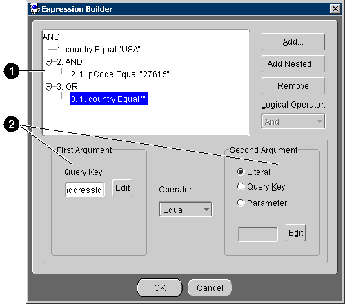

Use the Expression Builder to create TopLink Expression queries.
To Build an Expression:
  - From the Named Queries Format tab (see Figure 4-5), click Edit (or double-click a query string). The Expression Builder dialog box appears.
  - Figure 4-8 calls out the following user-interface components:
      - Expression tree
- Arguments
- Click Add or Add Nested to create a new expression. TopLink assigns a sequence number to each node and nested node.
  - Click Remove to remove an existing expression.
- Select the node and use the Logical Operator drop-down list to specify the operator for the node (AND, OR, Not AND, or Not OR).
- Choose the expression and complete the "Adding Arguments" procedure.
- Click OK.

  - Select an existing expression or click Add (or Add Nested) to add a new expression to the named query.

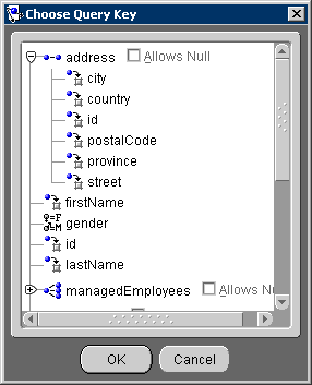

- For the First Argument, click Edit. The Choose Query Key dialog box appears.
- Select the attribute, specify if the query allows a null value, and click OK.
- Use the Operator drop-down list to specify how TopLink should evaluate the expression.
- For the Second Argument, select Literal, Query Key, or Parameter, and click Edit.
      - For Literal arguments, the Edit the Literal Type and Value dialog box appears. Choose the literal type (such as String or Integer) and value.
- For Query Key arguments, the Choose Query Key dialog box appears (see Figure 4-9).
- For Parameter arguments, use the drop-down list to select the specific parameter, as created on the Named Queries General tab (see Figure 4-4 ).
