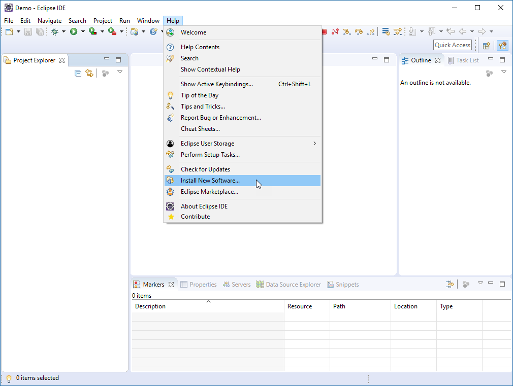

Step 1
enlarge
  1. Select Help > Install New Software... menu.

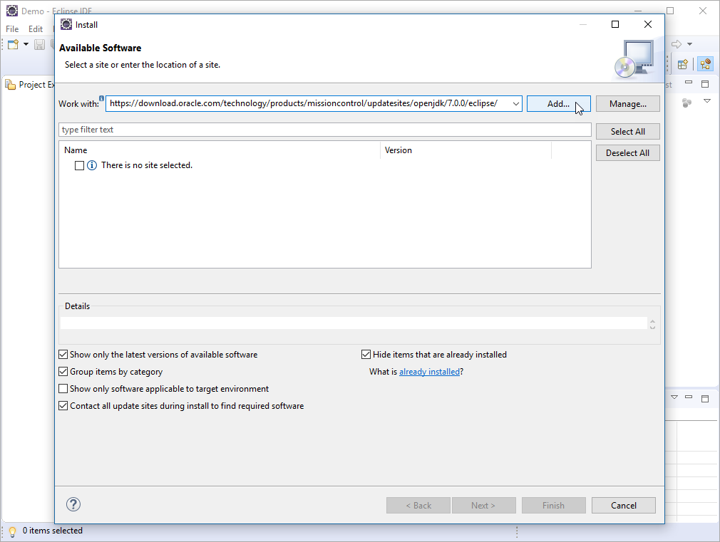

enlarge
  1. Fill in the following URL in the Work with: text field:
    https://download.oracle.com/technology/products/missioncontrol/updatesites/openjdk/9.1.2/ide/
    Press the return key.

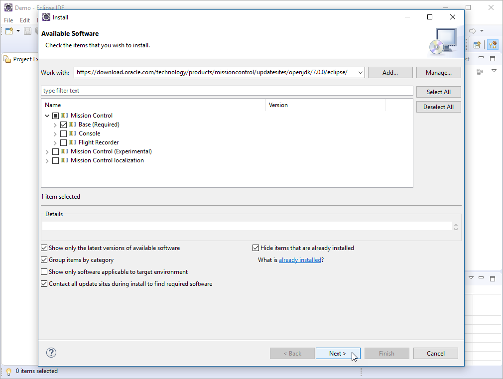

Step 3
enlarge
  1. Make sure that the check box next to the Mission Control/Base(Required) list entry is checked. Click on the Next button.

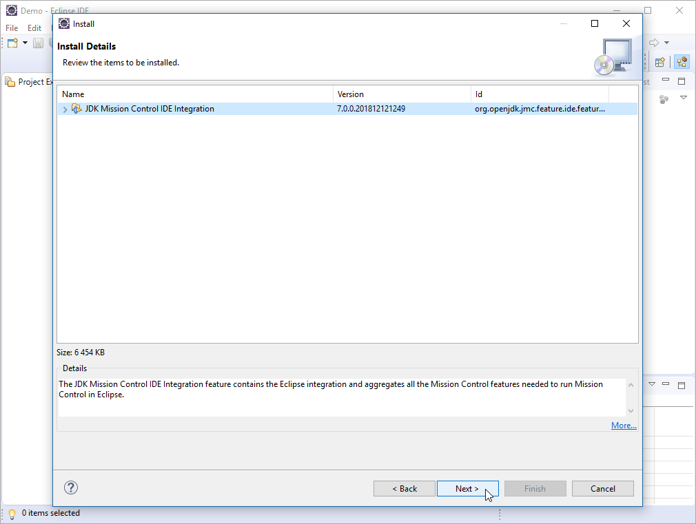

Step 4
enlarge
  1. View details for the selected features, then click on the Next button.

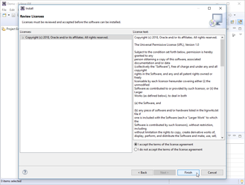

Step 5
enlarge
  1. Select I accept the terms of the license agreement, then click on the Finish button.
    Make sure that no Security Warning dialog appears. Oracle always signs the JDK Mission Control plug-ins, so if you see such a dialog you should verify the authenticity yourself.

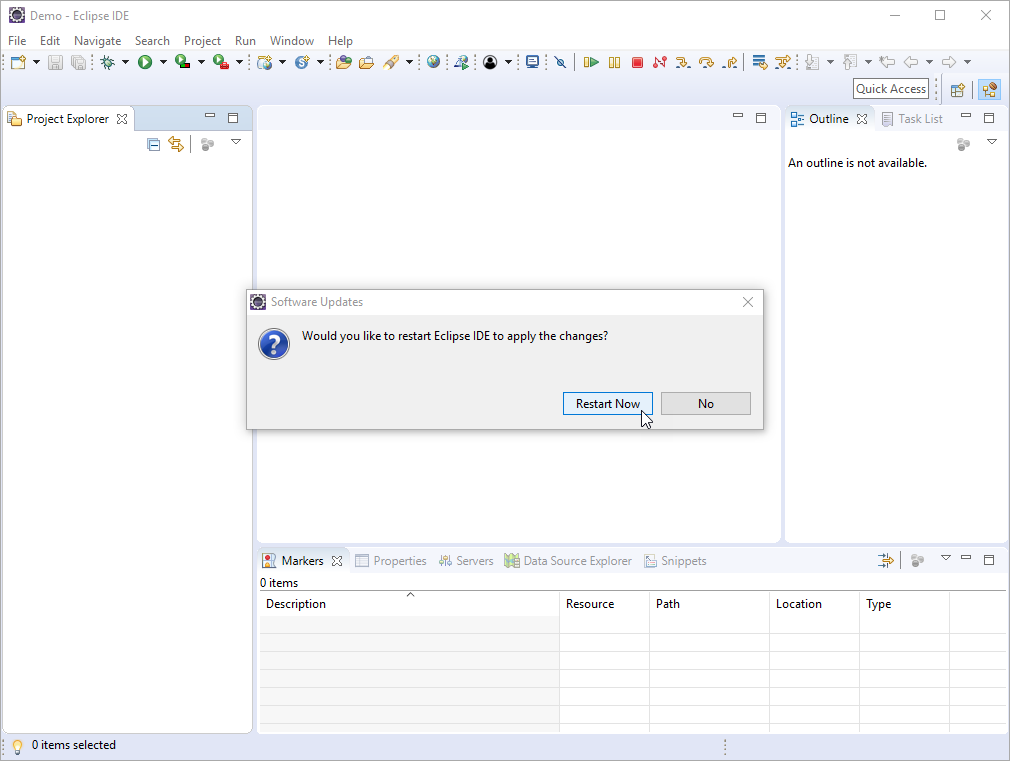

Step 6
enlarge
  1. Wait for the plug-ins to be downloaded, then click Restart Now to restart Eclipse and finish the installation.
