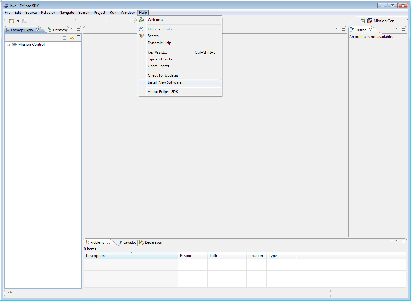

  1. Select Help > Install New Software... menu.

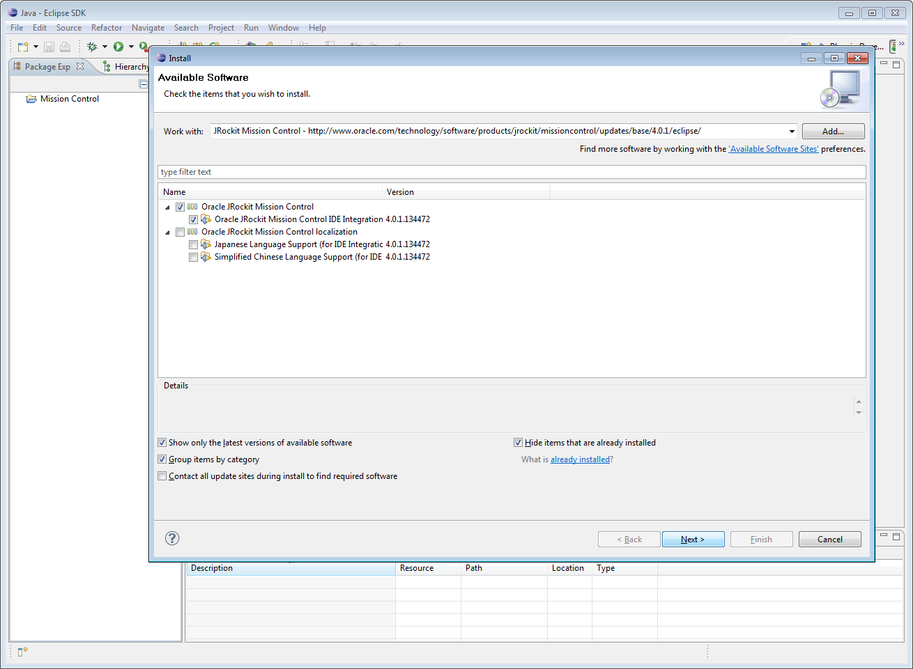

    Name your update site JRockit Mission Control and fill in the following URL:
    http://download.oracle.com/otn/missioncontrol/updatesites/base/4.0.1/eclipse/

  1. Make sure that the check box next to JRockit Mission Control list entry is checked. Click on the Finish button.

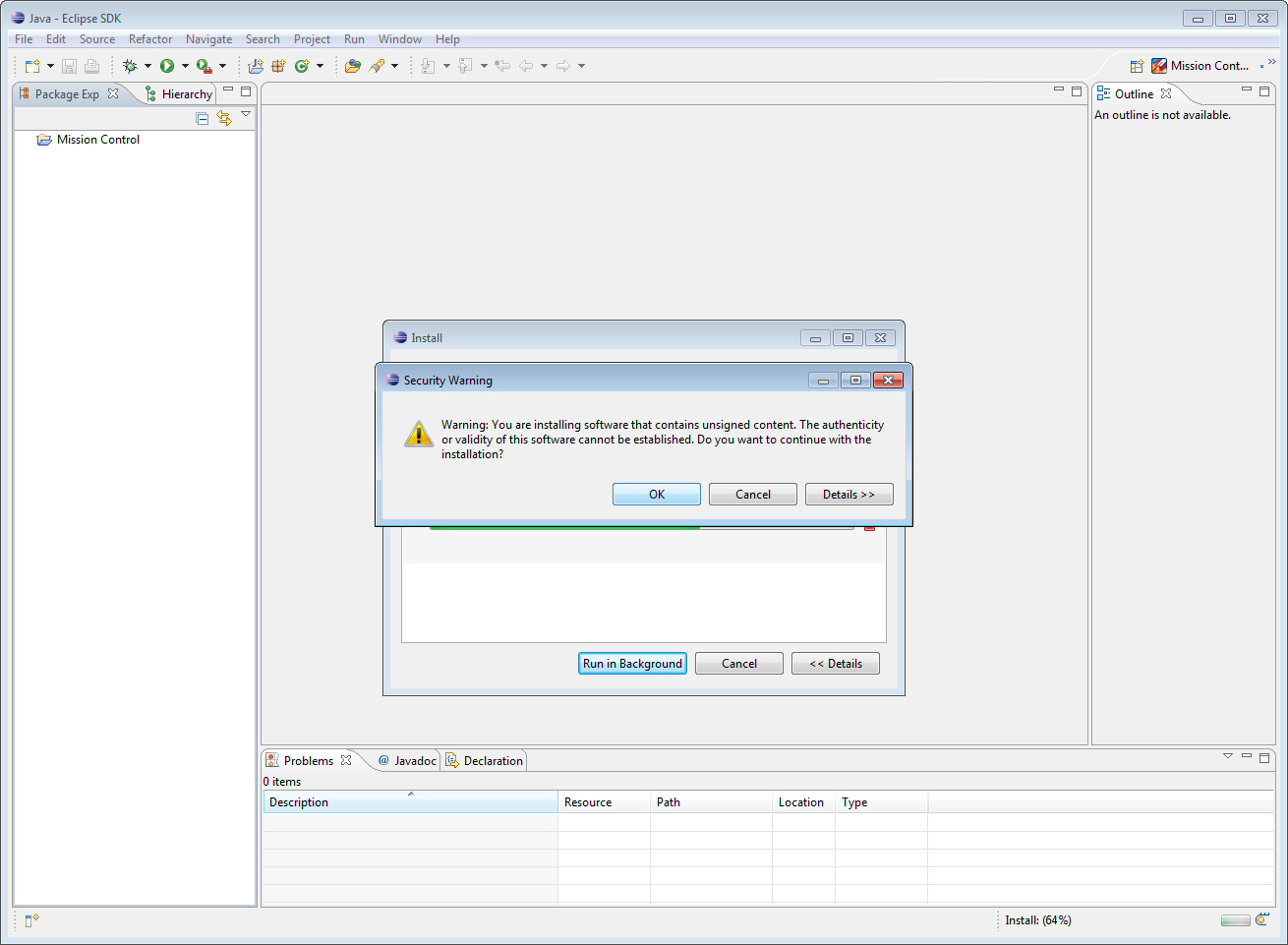

  1. Wait for the plug-ins to be downloaded, then click the OK button in the Security Warning dialog.
