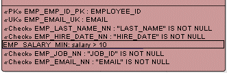

To edit a constraint definition on the diagram:
In the constraint compartment (the third compartment on a modeled
table), select the constraint definition you want to edit. Click once
to select the right place, then click again to enter edit mode. You
may need to resize the table definition to see the constraint.
To edit an existing constraint, type your changes into the selected
line. The information displayed depends on the type of constraint. The
following illustration shows a primary key, a unique key and some
check constraints. The check constraint
EMP_SALARY_MIN is
highlighted and the minimum salary has been changed to 10.
Use the following formats:
Primary key
<<PK>> --
<CONSTRAINT_NAME>: <SELECTED_COLUMN1>
, <SELECTED_COLUMN2> ...
Unique key
<<UK>> --
Check constraint
<<Check>> --
<CONSTRAINT_NAME>: <CONDITION>
