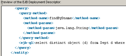

  11. In the EJB Module Editor, click Preview XML.
    Notice the query tag that was added.
