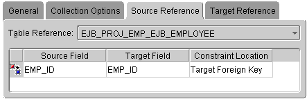

- Click the Collection Options tab to specify how the source descriptor relates to the relation table. See "Specifying Collection Properties" for more information.
- Click the Source Reference tab to specify how the source descriptor relates to the relation table.
- Use the Table Reference drop-down list to choose a reference whose foreign key is in the relation table and that points to a table associated to the source descriptor.
- Click the Target Reference tab to specify how the reference descriptor relates to the relation table.
- Choose a reference whose foreign key is in the relation table and that points to a table associated to the reference descriptor.
